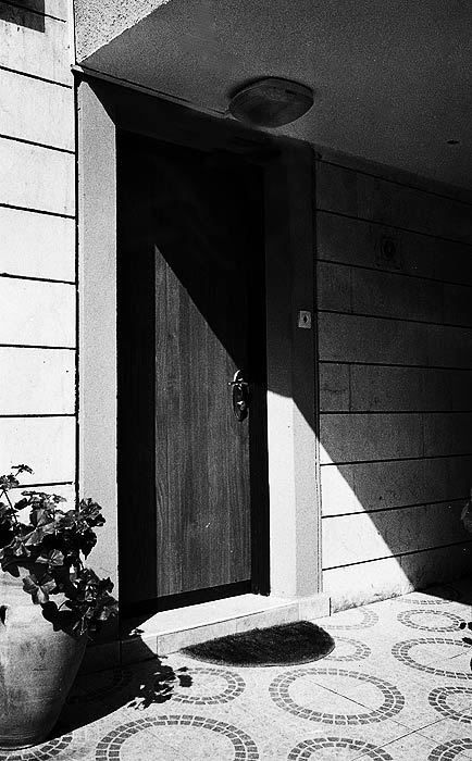

In previous thread I did it at 1600 and the negative got thin, but good for scanning. This time, I saw gorgeous contrast and open shadows. Seems to me that highlights are burnt a bit. Attached samples were worked in PS for levels to my taste.
I think TRIX will be best developed in Diafine if shot at 800 or 1000 ASA
Look and add your comments

IZr,
What do the highlights look like on the negs? Is there detail there? It's hard to tell on a computer monitor.

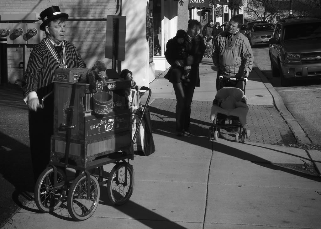

I shoot TriX at 1250 and develop in Diafine. I like the look. See below:

Thanks, SRTIWARI. I used to use DDX, which I also like a lot, but have been using Diafine for about the last year or two and find it works well for me. When I started with Diafine, I was shooting TRIX at 800, but have found that 1250 works best for me.

Jeff, I think you are losing shadow detail, too. Maybe my monitor (or your scan), but the women in the photo has nothing, coat and pants. The child's face is a zero too. Shadows are blue (sky) light so maybe it is just your Yellow or Orange filter. But as someone said don't use it on some similar shots and see if things are better.

Thanks Jeff.
I am ready to go with TRIX at 800. Next step will be 1200.
The door you see is our home entry
Attached is the full frame shot negative (horizontal version)
