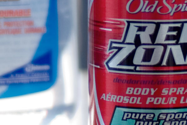

Now the two 100% crops - one for "detail" and one for bokeh.
First the detail.
Again, Cron goes first.
Now the Voigtlander
The words "Durable" and "Family" on the Future Floor Wax bottle can be discerned from the Voigtlander image but not from the Cron image. The black colour in the Old Spice canister is deeper in the Voigtlander image than the Cron image. I don't know whether these things are "good or bad" but right now.. the Voigtlander don't look so bad @ f2.0 😉

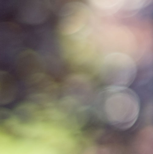

Now the bokeh crops.
Cron first
Voigtlander next
Ahhh.. the Cron clearly has the round, circular bokeh goin on versus the decahedron look of the Voigtlander. The decahedron doesn't exist in the Voigtlander @ f1.4 but the resulting bokeh is a whole other story 😀

As for the close up, it does seem that the CV's acutance is higher, but that could be due to misfocusing. Did you bracket your focusing? If not, then your detail might only serve to show the limits of consistently focusing a lens wide open on the M8.

With respect to focusing; both were focussed to the close focus distance on the Red Zone can, to the top right of the can where the red "swirl" comes down from the red cap into the silver area.

To my somewhat trained and critical eye there is not much difference. I think I'd need a grid overlay to really see the barrel distortion - it's just not apparent to my naked eye. Sure you can see a bokeh difference in the crops, but who really looks at magnified out of focus areas?

The images show the cron to be somewhat sharper, but not necessarily enough to matter. The impression of sharpness of the CV is from contrast/exposure. Look at the 's' in aerosol and you can see there is much less fuzz on the leica image. Close however in terms of real world perception. where this might matter more is not where you have block like delineation (as with this graphic subject) but fine details such as with grass, tree branches, distant detail etc. The test was perhaps most relevant to shooting people and in this regard the central subject with a lack of fine details is perhaps appropriate. The test is the opposite to a landscape type image or even a street scene with brickwork that would show distortion and fine details possibly present towards the edge of the frame.
I am not knocking the test as it does what it does just fine - for centralised subjects up close the CV looks just fine. I would be interested to see what they both look like at other apertures shooting a scene with edge to edge detail. Thats probably irrelevant to some of you, but important to others.

As for bokeh, isn't the reason that the Summicron-ASPH produced round circles because it was wide open at f2? The Nokton was closed to f2 from 1.4, so it has the edges of aperture blades to 'square off' its circles? If the Nokton were shot at 1.4, wouldn't its circles also be perfectly round?
But, at 1.4, i've seen some ghastly bokeh from the Nokton. That was the primary reason i never considered that lens. But, if you treat it as an f2 lens, maybe its value, ironically, increases quite a bit?
