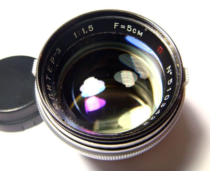

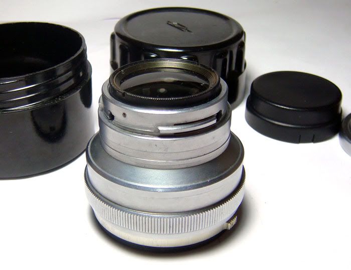

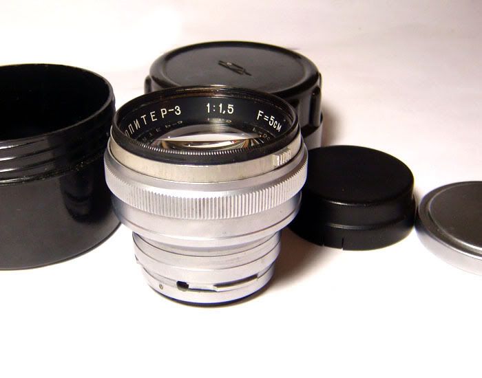

Here are 3 pics of the lens. The seller was honest about it all, and he sent me the lens that was portrayed in the ad.
serial number: 5103422
The lens looks very clean.
The third photo of the lens suggested to me that it was made by KMZ. The logo can barely be seen.
