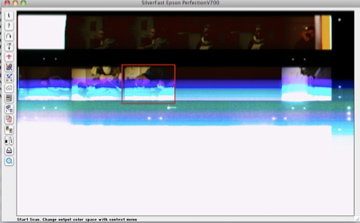

If you quickly ask me about the scanner I must regretfully admit, don't buy it!!
-Im obtaining soft images with film scans in the trays (not wet yet)
-Some images are corrupted after scanning
Does anybody knows how to put this thing to focus properly on the slides (thats what im guessing)
thx in advance
edit: OUCH, what's happening here?
what about the crazy pre scan and same results when scanned... used the scanner only 5 times!!! OMG!, looks dead 🙁

You're picking up a lot of white in the bottom half of that scan. Are you over-scanning the holder (scanning the light source)?
Anyway, If you suspect a bad scanner, maybe try scanning something different first like a piece of flat art (something that covers the whole bed).
Frame positioning?
Frame positioning?
Whenever I had results like this it was because I had the film holder placed too close to the hinge. The scanner needs a bit of open space in the glass because it uses that part to set its exposure. Hence the gap there on the various holders.

Believe me I want to be the one who says this scanner rocks! It was more kind of a way to say it. Will try all suggestions and see what happens.
One other thought -- maybe you have not removed the plastic Film Area Guide that sits on the glass? This forces the scanner to focus on the glass rather than on the film holders.
It was exactly that!!! how'd you know? Thanks everybody...
