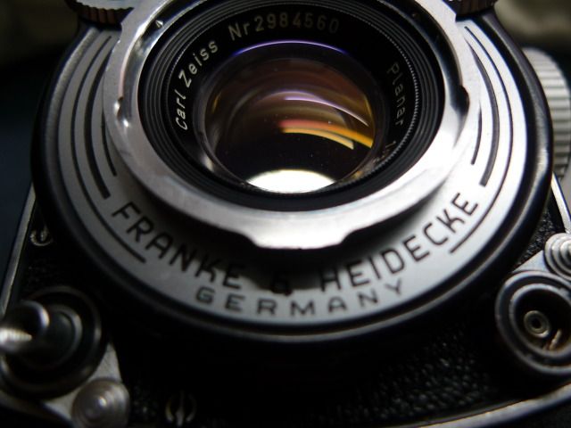

I sent off my Rolleiflex automat to Mark Hansen and got myself a 2nd rolleiflex, a 3.5F Planar which just arrived today.
The taking lens has some weird little specks which can only be seen if I tilt the lens at a corner or if I look really close up. It's not surface dust. Is this any reason to be worried about? Will this spread? The seller mentioned that the lens are clear and no scratches, haze, separation or fungus. I have yet to load film to test it out. Should I run a test roll into this first or send this back to the seller? I will be uploading pics of the specks in awhile...
Any insight about the little specks would be really great help.
Here are some pics

The first of your pics certainly shows a lot of spots !
If you're certain they are on the inside, they can only be dust or deposits of vapourised lubricant, and as such can be removed quite easily by a good repairman. They don't have the appearance of anything nasty, like fungus.
They're unlikely to be a problem photographically - taking lenses can be really battlescarred with deep scratches and still give a perfectly good image - but may cause flare in certain lighting conditions, so using a lenshood is advisable.
If the purchase price was favourable and everything else is OK, you've got a good camera...
I've seen dirt or marks on the rear lens look like spots on the front lens. Check to make sure the rear lens is cleans.
Myself, I wouldn't lose any sleep over it.
Hard to tell form the photos exactly, but if all you have are small specks, dust-like dots, most likely they are simply just that-dust that has found its way between the shutter blades and the back of the front lens group. It is possible to remove the front lens without doing any other disassembling, clean the back of the lens group, and reinstall. But probably not worth it. The chance of it affecting things is minimal.
If the dots have any sort of 'ring' quality to them, then it might be drops of oil condensed or sprayed on the lens over the years from the shutter mechanism. The solution is the same- remove and clean- and the effect is also pretty well the same- most likely no effect. The only issue here is that the coatings could be adversely effected by the oil, but by now there's not much you can do about it one way or another.
Fungus- do a web search for lens fungus to find examples- is a long-term problem, but again its effect on images depends.
And then there is separation- this will show more as a rainbow crescent or other such pattern. This requires re-cementing the lens elements, and yet again, people will use such lenses for years without noticing adverse effects on the actual image, only on resale value. The seller should have mentioned, though.

I had the same type of spots, there were partials from the inside the camera, dust - that worked their way in between the elements. If there is nothing else wrong with the camera, speeds and transport - I would leave alone. I did eventually send mine to Harry Fleenor, who did an excellent CLA. His service takes time but is excellent. Corrected many things. Good luck.
It's either dust or tiny losses in the coating.
The images won't be affected the least so if the shutter is OK at all speeds, leave it as is.

The Automat has a Tessar and so there is less glass in front of the shutter, so, less space for dust to get in, and the elements in front of the shutter don't magnify the dust spots size as much as what the Planar does.
3.5F Rolleiflexes are getting hard to get at reasonable prices so think of it twice before you get rid of it, if this one has a working shutter, a parallel standard, a straight back and a working meter.
Having it serviced would be a good idea anyway and the pics tell that it wasn't butchered in the past - I'd guess it was never opened given the look of the leather pieces on the front plate.
