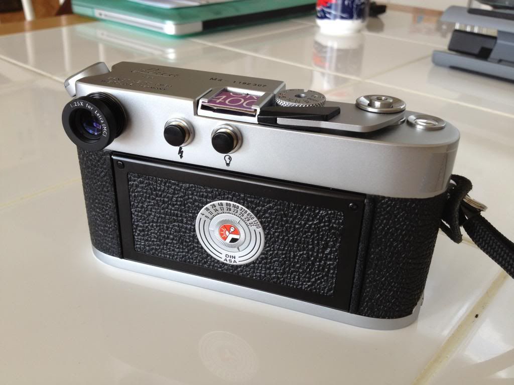

Personally, I use a Leica M4 x.072 with a x1.25 magnifier from Phottix (Chinese): http://www.phottix.com/en/accessories/1-25x-viewfinder-magnifier-for-leica-black.html
At first I was hesitant to buy from them since there are highly regarded magnifiers from Japan Exposures, Leica, etc. but when I received it in the mail it exceeded my expectations. Really clear, multi-coated, solidly built and it even came with a tiny leather case like the Leica one does. Here's a quick snap from my iPhone:
The viewfinder itself makes it even easier to keep both eyes open while shooting. I wear contacts usually and with the magnifier I can see a little more than the 50mm lines. With glasses, I just take the viewfinder off all together so I feel like the x1.4 might be a little too much.
The only thing I miss is the nearly flat back profile of my M4 :p
