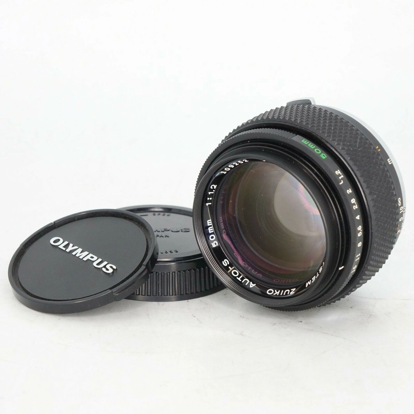

The super-speed 7-element, 6-group 50mm f/1.2 Zuiko is a great choice for capturing vintage look bokeh at its widest apertures and for low light work It’s capable of very sharp imaging when stopped down and is much more compact and somewhat lighter than other 50mm f/1.2s but noticeably heftier than the 50mm f/1.4. The last version of this lens, with recessed front element and lens identification info on the outside of the barrel is said to offer better performance overall. Price range: $350-$550.
rs=w:1440,h:1440
50mm f/1.2 Zuiko, original version.
