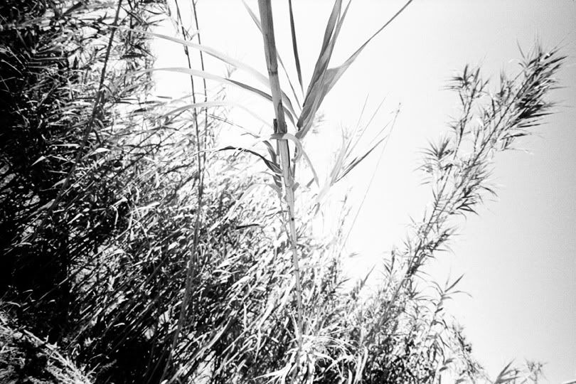

I assure you, there clearly is DOF and OOF areas in close focus shots. these testshots were taken with 400asa in bright daylight, that means far from wide open. focus set between 30 and 40cm afair.

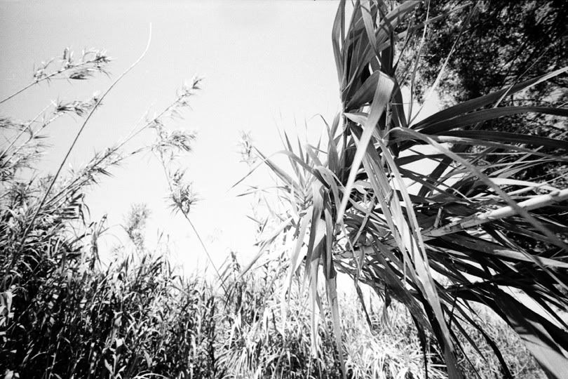

and I just found this, wide open but not at closest focus distance:
this is a narrow kitchen, I imagine a vaster background like a restaurant to be a lot more visibly OOF.
