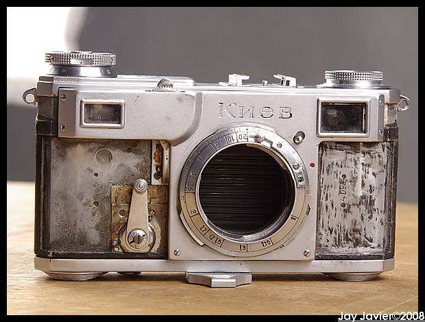

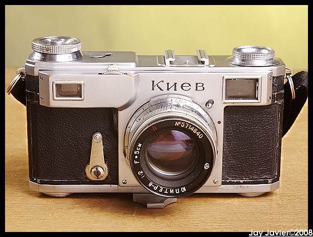

Kiev-2. Restored April 2008.
This 1951 Kiev-2 was found in a working state, cosmetics not too good. The original leather(ette?) covering was torn and peeling. So it was stripped bare for recovering.

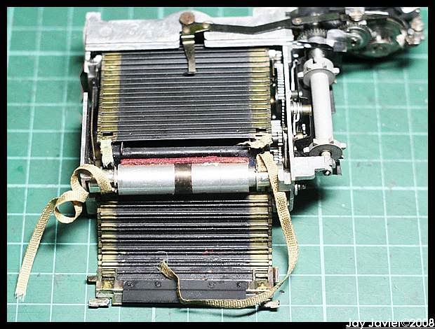

As expected with old Kiev, the shutter ribbon broke, one at a time. Left ribbon first, then the right. And they broke exactly where someone (very knowledgeable on Contax repairs) had pointed out where they always break: about 1-2 mm from the sewn upper ends where the most wear happens.

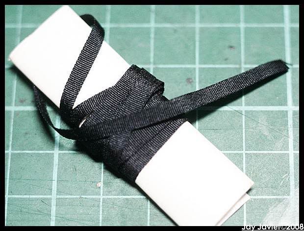

The ribbons were replaced with Aki-Asahi silk ribbons. 100% natural silk and very tough. Fits the friction clutch of the Kiev (and Contax?) width-wise. That's 3mm. The clutches have to pinched a bit to make them grip the ribbons. Without the clutches pinching, the lower curtain will fall loosely, pulled by the middle spring of the bottom roller. A properly 'pinching' curtain should not drop down easily even if it doesn't cling on the upper curtain tightly.

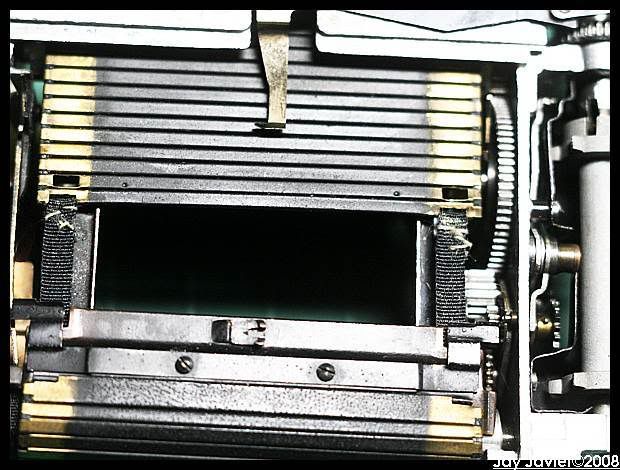

The ribbon is installed. Note the attempted cross-stitch. Tried to follow the stitching instruction given by I. Maizenberg. But clumsy fat fingers won't do good work with tiny needles on tiny ribbons. The works were also cleaned by spraying them with naphtha, and oiled with thinned 3-in-1 oil.
After fixing the shutter and calibrating it, a new skin was put on the Kiev. I used inexpensive thin vinyl leatherette bought from an upholstery supply store. The Kиев logo was filled in with black paint. It eventually rubbed off.
This Kiev is now a fine shooter. Perhaps a dozen rolls of film have gone through it. And contrary to the myth, it doesn't really need much fondling nor servicing every other week or so ....:D

Using TV-screen test, and following basic adjustment tips from Maizenberg. I suppose the speeds are within acceptable range- haven't gotten bad pictures from erratic shutter exposures yet. No unexpected dense or thin negatives so far with metered exposures.
By the way these examples shot by the restored Kyiv-2 look, the shutter seems to be exposing well enough for practical purposes:
(Fuji Neopan 400, with yellow filter, 35mm J-12)
(Lucky color 200, 50mm Jupiter-8 /lens shown above with the Kiev-2)​
