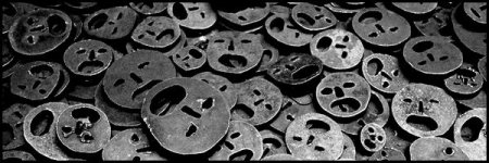

attachment.php
A detail of the art installation Shalechet (fallen leaves) by the Israeli sculptor Menashe
Kadishman in the Memory Void of the Jewish Museum, Berlin.
attachment.php
The leaves disappear into infinite darkness.
