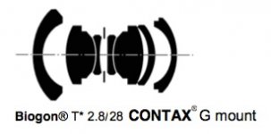

Zeiss lens naming derives from the optical formula. The basic Planar is a six element lens in a symmetrical arrangement with a positive element at front followed by a positive/negative cemented pair, same reversed behind the diaphragm. So, 6-elements in 4-groups, a very widely copied arrangement for normal and short tele lenses. This is the design of the 45 Planar-G. The 35 Planar-G is a slight modification, with an added weak positive just behind the diaphragm, same as the Voigtlander 40 Nokton. The Biogon formula is used for wide angle lenses, and also tends to be symmetrical or nearly so. But it has strong negative elements at both ends.
