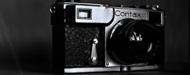

Right there is waaaay too much chatter about the M8! So instead I decided to try out my field camera that I *still* haven't used properly, and I managed my first 4x5 neg....and it was successful!!
Here's the waffling you can glance over:
It's the pet project that I neglected, honestly. But at least I bought a few extra half-plate backs, and built a recessed lensboard and attached a Wray Supar 4,5inch enlarging lens to it! (also have a spare Wray 4,5inch, and a Ross Xpress 8,5inch enlarger lenses - either for this camera, the 10x8, or for when I actually GET an enlarger!!)
Anyways, a while back I bought a box of Kodalith Ortho or something. 100 sheets of 4x5 negs. They sat un-touched since I bought them months ago. I cracked open the box, tried to fiddle around with one of the half-plate backs until I decided "f*ck it. I'll waste these two sheets and work out how to do it in the daylight!"
The afternoon doesn't last too long so I had to work fast.
I set up the Kiev-Contax on the bookshelf,
placed the camera on a tripod that can hardly support it,
set up the composition on the ground glass - trying to compose the shot in the bottom left corner, where the neg would sit.
Right, so it's a major hassle trying to get a 4x5 neg to stay put in a glass-plate holder built for something 1/3 larger! I practice in the daylight, close my eyes and practice a few more times.
The corner of the film that isn't covered by the frame likes to catch on the darkslide/slat. That's inevitable.
So anyways I take the photo, about 5 seconds I think. *remove lens cap, look out the window at the darkness drawing in, replace lens cap*
Here's the important bits:
I use my 2-reel 35mm developing tank as opposed to the paterson orbital, clipping the corner of the neg to the central cylinder, so that the neg is angled in the tank, and a clockwise rotation with the agitation doohicky will allow the whole neg (either side) to be submerged without inconsistency. of course, where the neg is clipped there is a TINY spot undeveloped.
Rodinal, 6+650ml (basically 1:110 because I'm too impatient to try 1:200 or 1:300), about 6 minutes or so. Don't ask why it's 666!
This film is insensitive to red light, so in the future I may use a safelight and print by inspection. Course, first thing's first I need to create a proper neg holder within the half-plate backs!
Attached is me holding the neg up to the light, and also the neg placed on my laptop screen, then inverted. Beware interlacing!
Not bad for first try, eh?

Right, I'm scanning the neg best I can... I removed the 35mm holder and I'm using the total light-area for the scanner. It's crying. You can see the crop immediately, but it appears that although dark, the neg is quite well exposed (even so thin). There is obvious tone in the image.
I just scanned it at a resolution of 4800, and it's crashing the pc to save it
Ash
Selflessly Self-involved
Here's two images. Both are as the scanner-god made them (no auto-levelling, just as the light could manage).
First = resolution of 800
Second = cropped area of lens reflection at 4800, resized 50%.
So I need to practice on focusing and getting the best from the camera/lens/film combo. You can see pinholes in the neg as I STILL haven't found and remedied the cause.

Hey, well done on the 4x5 front, it's good when you get to make something and it really works, nice one. With practice (use an old lens as a loupe on the ground glass) and you'll be doing more accurate focussing wide open.
Ash
Thanks Tony. The focusing problems are a result of a few different things.
Aside from inexperience using LF, I left my magnifying lenses upstairs; I have two high magnification elements from 2x converters that have worked well in the past.
On top of that I was using natural light from the patio doors, so I had a huge amount of glare on the focusing screen, and no dark cloth to place over it (laziness etc).
The tripod I was using is for lighter film/digital/video cameras so there was a lot of 'play'. This meant no matter how hard I tried, the camera would move, and that's not good with a long-ish exposure.
Also, the shot is wide-open f/4,5 which means the focus could be a little soft.

EcoLeica
Check out my blog!!!
wow....good looking pics you got there. I think your work has just pushed me to buy a large format camera that my camera guy is selling for $150. Time to start learning to make bellows!
PS what lens was used?

It's a Wray Supar enlarging lens - 4,5inch. They're dirt cheap! I picked up two for a fiver or something silly like that!
Look for a really good enlarging lens, but you'll want to have a shutter of sorts. I'm using a lens-cap since I've not yet sourced a cheap shutter.
The camera itself cost £25, the extra backs were something like £30, lenses and wood for the lensboard £10, box of 4x5 ortho £35. That was over a couple months
Edit: An identical LF camera was on ebay for £145 buy-it-now with lens/shutter as well
