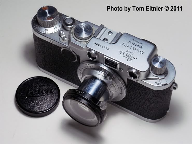

Original 1951 Leica IIFBD with matching f3.5/50 Elmar w/ A-36 UV Filter

The A36 will work with the 28mm Hektor, 35mm Elmar, 90mm Elmar and as well with the 135 Hektor, I just have to adjust your apeture before you put the filter on......
Tom
