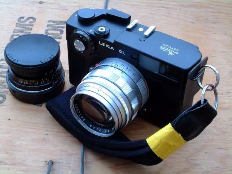

Type 2, 43mm filter thread, chrome, circa 1964:
Wide-open:
Wide-open:
