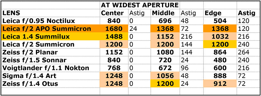

With respect I don't believe your results.
Here is a serious test:
http://www.lensrentals.com/blog/2014/06/comparing-rangefinder-and-slr-50mm-lenses-version-0-7
Wide Open:
The 50 Lux asph, as Puts might predict, smokes everything but the 50APO and basically equals the Otus.
The Planar is also behind, with the Zeiss Sonnar way out: as the older design limitations would suggest.
Note the 50 cron non-APO is 1200 1200 1200
Of course that is f/2, but compare to planar.

Very interesting to compare the CV 50/1.1 to the Leica .95 in these tests. Some claim the Cv is a bit 'soft' LOL, but it's better mid and edge WO than the .95 and not that far off in the center. And half the weight

What distance was the target?
The Lux ASPH has a mid zone dip and then recovers at the edges. If you're testing at near to medium distances, this becomes quite evident, especially until around f/4. At portrait distances, I find the Lux ASPH difficult to hit focus with at f/2.8 with the RF and the subject's eyes placed in the rule of thirds. It also gives up a bit of sharpness at nearer distances despite the floating element.
At infinity, the Lux is more consistent across the frame. The mid zone dip is still there, but not as noticeable. I have used it to shoot infinity scenes wide open and have been very happy with the results. My experience with the C-Sonnar is that it's not as good here. The center sharpens up but the edges lag until stopped down somewhat. But it's not really where the C-Sonnar is at its best.

Surely numbers don't lie?
Yes, I'm quite aware of those tests and many more done by others. My observations were not numerical but impressions of sharpness. The targets were in a plane about ten feet from the camera and tripod, a distance typical for my captures. Also, the zone of sharpness was not confined to a doughnut centered about the midpoint, but extend well past this and was symmetrical about both sides. My observation is empiracle, and ; therefore my personal lesson is "Try before you buy".

"Impressions of sharpness"?

Yes, sharpness is an imprecise term. It is a subjective word unless defined precisely. The resolution numerical data is a precise definition; The line pair resolution is higher. But how does this relate to how a photo looks?
May I suggest that my impression of sharpness is related to an effect not obvious from the data presented. Perhaps it is not so crazy an idea that the neurological "impression" of sharpness is not only related to lp/mm but some other optical factors?

I still find it interesting that results from one single lens compared with results from another single lens are taken without doubt as being fully representative of all such lenses.
As much as I respect Roger's work, it may really be more representative for several of us who own these lenses to ship them off to Roger and have him repeat these tests on all of these lenses and see where things play out. I think that people would be quite surprised, maybe even shocked, at the leveling effects from the averages of a group of real life lenses that are being used on a regular basis.
Further, I think that some type of cost effectiveness measure has to be considered as well. I find it extremely instructive to see how closely the $850 Leica Planar and the $2500 Leica Summicron compare.
Finally, how many of you that own a $7,000 Summicron really believe that you are achieving those stellar results from your handheld shots on the street? I think the reality is that we are all realizing very similar results from our various lenses regardless of the actual dollar amount spent. The tiniest amount of focus error or camera movement will totally negate all those terrific test results.

I have the Summilux 50 Asph - and the C-Sonnar 50f1.5 (and Planar 50 etc). The Summilux is sharp and contrasty - but it lacks 'soul" - the C Sonnar 50f1.5 has it - at least in black/white.
Further more, what is interesting in the test is how good the Nokton 50mm f1.1 is compared to the $ 10 000 Noctilux 0.95!
Yes. I would like to have a 50 Summicron Apo - but at $ 7000 I am not getting it. Shooting film you would need to shoot everything with ultra fine grain film to even see the difference.

Lastly, while the tests are probably pretty good, Roger calls them preliminary, and not to be taken as definitive. Its a work in progress and we should see some more info from him in the future. His favorite camera? Leica MM.
