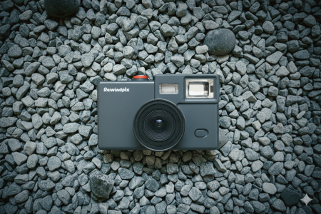

2 colors for now: Grey and beige. Would be great if you can help me to think of 2 cool color names for KS launch and Shopify store. thanks
Grey:
see rely for image

Front:
3 Key features of the front:
1. Swappable large shutter button:
Large = 1.5CM diameter. I am a shy and innie person, I don't like to use extreme words. Here I will use "could be" the largest shutter button in the market.Material = Aluminum, CNC cut
Swappable = yes, it got a copper thread, users can swap the shutter button to other colors down the road to fit your mood. Even a football (soccer) in summer 2026.
2. Xenon flash
I don’t think any vintage digital or film cameras had LED flashes. So my option is simple: use a proper one. I considered getting rid of the in-camera flash and adding a hot shoe, so users could attach their own if needed. However, this camera is designed for daily carry and impromptu use, and an in-camera flash will always be useful—especially when users are drinking or dancing in a dark place, I guess.see rely for image
3. Might be the largest optical viewfinder in the market
Large = 2.5cm X 2cm. Magnification = 0.78x.Field of view = 40mm (with frame line), 35mm (without frame line)
Again, I am an innie, I will use "might be" here based on my research. Please correct me. Thanks.
Optical viewfinders in the current 3D-printed prototypes were scrapped from Agfa Optima Sensor cameras I bought on eBay. Since the camera has no LCD screen, the OVF is the only channel that connects us to the world through the camera. Therefore, based on my preference and my experience with tiny tunnel-vision viewfinders on other screen-free cameras, I decided to provide the largest one possible for my product. So your experience will switch from squatting in a submarine using a periscope to standing on the bridge of an aircraft carrier.
Grey:
see rely for image
