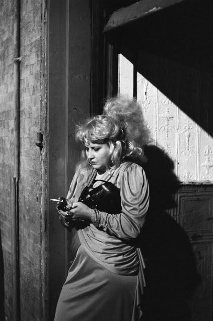

Proteus617

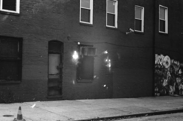

My Fed2 with a curtain like swiss cheese. Low light and recently wound-on. The "smoke" above the cigarette is actually a light leak.

From the same roll, bright light and driving around with the camera on the passenger seat and the lens cap off.
