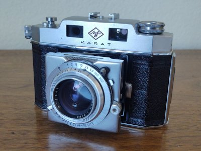

I have a Karat IV with the Solagon in nice shape. This takes standard 35mm film and a more normal rangefinder system than the earlier models. The film is advanced with a lever but in the reverse direction.
