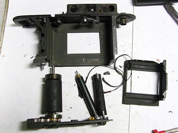

I bought this Leica IIIf black dial from KEH last week. It was advertised as Ex condition with wrinkled (cracked) curtains and speeds off for $172.00. Both curtains were shot so I replaced them with silk-rubber material from Aki-Asahi. The camera was cleaned and relubed by me and speeds adjusted to specs.
I just hung the first roll through to dry so I'll soon know how it did. Negative do look properly exposed so I am confident it is working as it should..
Leica or not Leica, it is always a pleasure when an old camera is brought back to life !
Greetings and Congratulations,
Ruben
Below is a photo of both curtains after removal. The top curtain is the closing curtain and while it can't be seen in the photo it has vertical cracking of the rubber coating. The below curtain is the opening curtain with little rubber coating left. Needless to say it was pouring in light.

Colyn, your original curtains are far better than what I've had to work with. 🙂

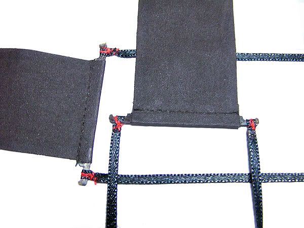

This is all that the last Leica I worked on had:
Did you take the whole crate apart and replace the whole thing? Have you tried doing the 'partial' replacement method described in the Nat-Cam repair manual? I'm considering to do this for another Leica repair I'm about to do.
Regarding the curtains, did you glue or sew them? The ribbons in particular appear to need the stitching to prevent them from getting loose in the future. I also had tried stitching some of the shutter curtains to the laths too. With the cloth I used, the needle punctures needed to be patched with paint.
However, the Aki-Asahi silk/rubber/silk cloths close up tightly after stitching so that no patching is needed. The rubber coating is so flexible that it wraps itself around the stitching threads so even the needle punctures get covered.
The stitching appears to be unneccessary when modern adhesives are used; many references don't require it. However, some shutters I have repaired over the years appear to be flaking off their glued laths; sewing seems to be the only stable means of keeping them in place.
I completely disassembled the crate in order to do a good cleaning job.
The problem with the partial method is you can't get to areas that need cleaning.
I glue and stitch the lathe ends. You need a very small needle and when stitching you should push through at a slight angle. I still put a bit of latex paint on the thread though.
The one time I used the silk-rubber-silk material I had problems getting the shutter to work properly but then I didn't make the tapes/curtains shorter like some have suggested..
For the added security I stitch all my new curtains and tapes. That way I don't have to worry if the shutter will fail..
