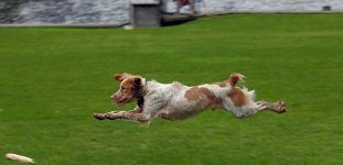

I purchased a 135 f/3.4 for use on my M bodies and have occasionally used it on the R-D1 i previously owned. I took very few pictures with it, mostly because I find that a 90 is all I ever need for the subjects I usually shoot.
That said, I did take some time to shoot a series of photos of my son's Brittany pointer retrieving by prefocusing on a spot on the lawn and then snapping the shot as the dog "flew" over it.
Here is one of the photos, which is a favorite.
Ed
