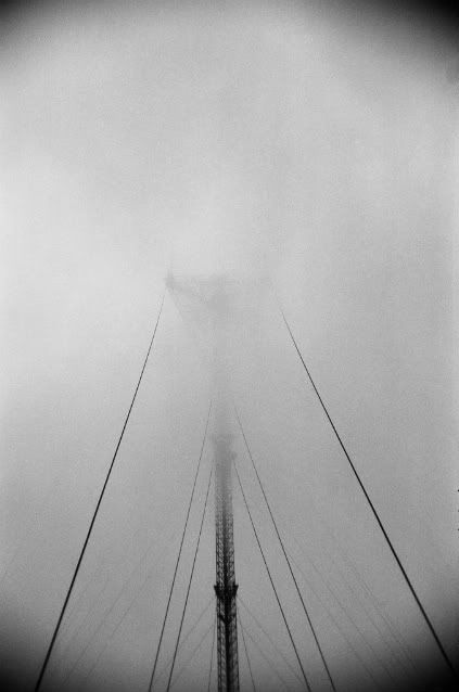

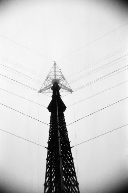

I just dragged an AF out of it's long retirement. A very fun camera. The viewfinder is much longer than the lens so you have to compose generously. I'm only 50% sure that I did not reverse the middle lens element during re-assembly. I'm pretty sure I glued the velvet light seal in it's proper position. Check out the vignetting when focused on infinity:
Tough to get a sense of scale here; that tower is 300m tall.
Fog rolls in:
The thin single mast behind stands almost 1300m. Vignettting greatly reduced when focused at 20':
I'd reverse the middle lens element and try again with a short roll of film.

Rick,
The folks over at the ACG confirmed that my middle element is flipped. A 30 second fix, and I and can even change the orientation

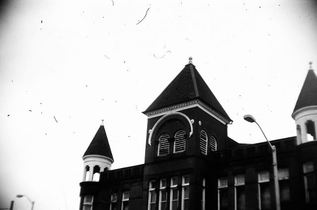

mid roll (not a bad feature). Before your first roll of film, I would highly recommend that you replace the velvet light trap in the barrel of the body. I re-glued my original trap when I should have replaced it. The 70 year old velvet sheds fibers onto the neg whenever I collapse the lens. The first photo of a series always looks like this:
Easy to gimp out, but almost unprintable in a darkroom.

Glad to hear it is a quick fix. I assume it's a simple matter of unscrewing the front lens unit and then unscrewing and flipping the rear lens in the unit.
