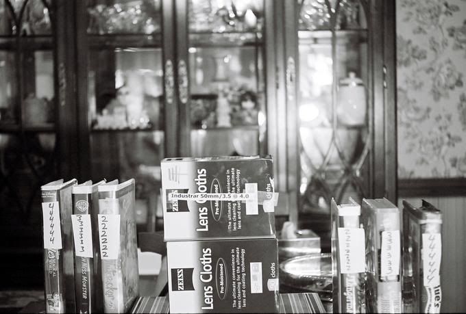

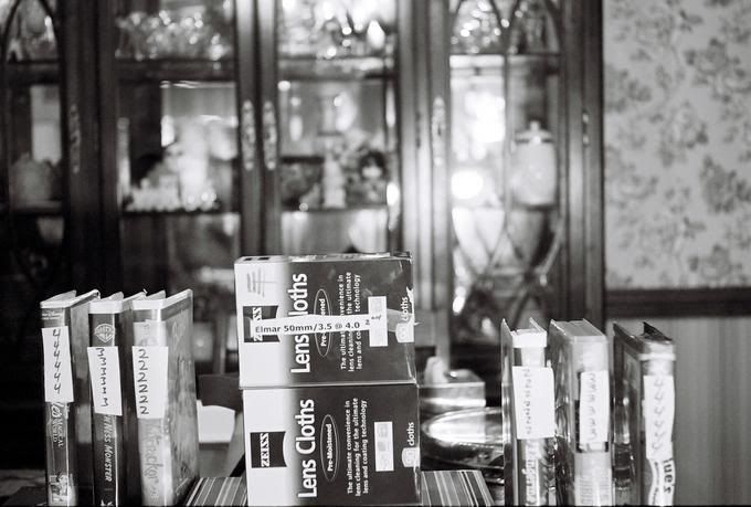

Hi Paul,
I hope that you don't mind my addition of a few old test shots for the I-50. I don't intend to side track your thread.
Here are some older results from a lens comparison.
I-50 rigid at 4.0:
Elmar 5cm 3.5at 4.0:
Paul I noticed that the shots taking with the BW400CN has a slight sepia tint to them. Sometimes I get it really bad. XP-2 is the same. It used to bother me but I found I can totally eliminate it by converting the image to 8 or 16 bit grayscale in my editing program. I thought I'd let you know because if you shoot a lot of this film it's bound to pop up sometime really bad!
