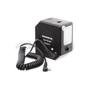

That said, I suggest you look into mini slave flashes:
Most of them will not have a hot shoe or sync cord, so you can't trigger them on the Bessa. But you can look for mini slave flashes on eBay and at photo stores.
Some of the better ones like the $30 Morris Mini Slave II and Mini Widehave a sync connection. Note that this again adds some electronics and size to the flash.
Those are still in the 2" size range because of the battery and sync electronics - in the NEX much of that is done by the camera. You won't get that in a film rangefinder, it's a case of "have the cake and eat it, too".
