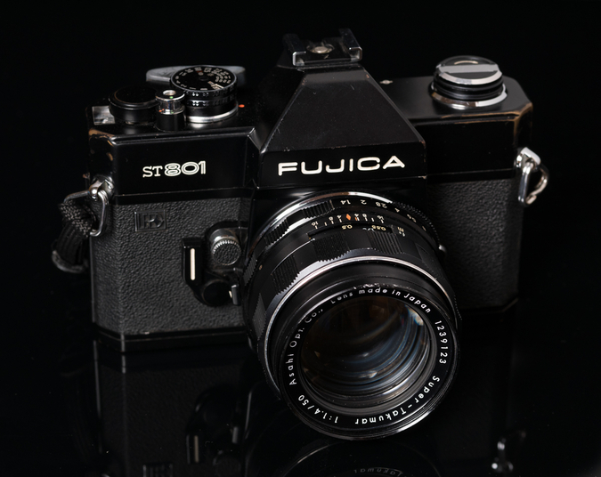

My vote is for the Fujica ST801, smaller than the Spotmatic (better in every way as far as I am concerned), all mechanical and will work even without the battery, much quieter, the viewfinder is significantly brighter and has a split-screen for focusing, top shutter speed of 1/2000, ISO up to 3200, and a LED metering system. Bessamatic is probably nicer, but you can get a ST801 for $50.
You can get a Bessamatic for $50, too, and they are a gorgeous SLR with some good lenses, but it will probably need some work before you can use it at that price, and even then it won’t mount M42 lenses.
I’d possibly buy an ST801 myself for $50 if I found one at the price, but I have looked at what they fetch online and it seems to be a bit more than that in recent times. Where I live they rarely appear for sale locally but perhaps you have better odds in your location?
