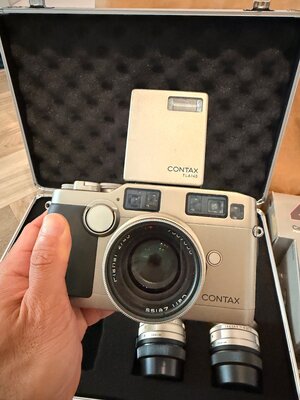

Hi all,
I was really hoping that my post would be about being convinced why I really don't need a Contax G2, but I guess the GAS was too strong.

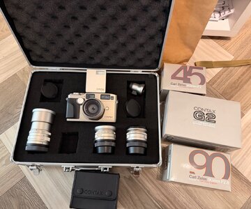

I'm picking up a Contax G2 kit tomorrow from a private seller. The kit includes the 21/28/45/90 Zeiss lenses plus TLA140, all boxed, in a hard case. Seller is a photographer but says he bought it more as a collector's item and didn't use it much.
Unit looks great in photos and seller says everything works, but since this is a private sale I likely won't have the option to return it or test it with a roll before committing.
What should I be checking on the spot to make sure I'm not walking away with a lemon? Any known failure points, red flags, or things that would make you walk away?
Ask if you can bring a test roll of film and use it. Check that it loads correctly, and snap close/medium/far shots with each lens to check that focusing is working (on the lens and on the body). Also make sure rewind is working at the end of the roll. Check shutter curtains visually for damage, and give the camera a slight jiggle to make sure viewfinder elements are not loose. Aside from that, I’d just make sure that all dials work correctly.
Good luck and enjoy! I have the G1 with the 45mm and 90mm and it’s a wonderful camera.
This is excellent advice. Thank you so much @jaredangle 🙌
