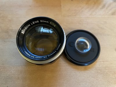

Hi all,
As many here know, the Canon 50mm f1.2 LTM lens is infamous for suffering from a type of haze/element degradation that, more often than not, cannot be solved with a simple CLA.
Some years ago I became aware that Kanto Camera, a preeminent repair shop in Japan, offers a remanufactured element that can be replaced during a CLA. Just this year, after failing to find a “nice” copy of a 1.2, I finally sent mine in for the service.
Today, just 6-months after I first mailed my lens, it arrived safely back in Portland.
Kanto Camera charged $250 USD for a CLA and the replacement element. Considering that this service isn’t available anywhere else in the world, I figure that’s a pretty nice deal.
I’m not affiliated with Kanto Camera but I think it’s important to highlight these type of repair opportunities, particularly when you must assume this service won’t be possible forever.

That’s great info. I have this lens and will send it to Kanto for the CLA and inspection. 6 months and cost is reasonable. Thank you for sharing.
I ended up buying Miles Canon 50/1.2, and compared it with my "mint glass" original 50/1.2.
The Kanto repaired lens has the edge. Better than new.
