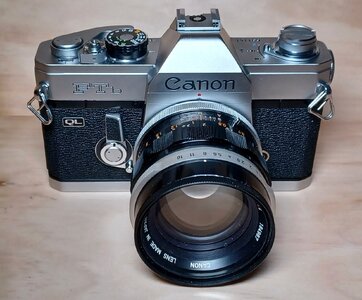

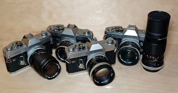

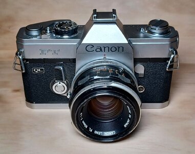

So, I received a Canon FTb today to add to my collection of Canon FT QL's. All of my lenses are FL mount. This means that I have to use stop-down metering with these lenses on my FTb body. My understanding is that if I were to use "newer" (non-breech mount) FD lenses on my FTb body, I wouldn't have to use stop-down metering. However, if I were to use a newer FD (non-breech mount) lens on my older FT QL bodies, I would have to use stop-down metering on my FT QL bodies.
So, my question is, if I use older breech-mount FD lenses (early generation FD lenses that are breech mount), will I avoid having to use stop down metering on both my FT QL and FTb bodies?
