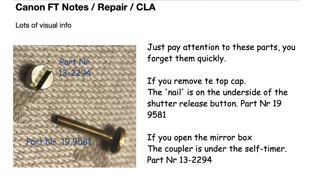

First, when I remove the top, the shutter button shaft always falls off. I guess this is not supposed to. Can I fix this by tightening the screw (part 13-8497)?

Thanks for the reply! Will take extra care not to lose it :)
On a side note, where is the picture coming from? I have a repair manual from Canon and a NatCam guide, is this from another repair book? Every repair manual I can get my hands on is welcome :)
