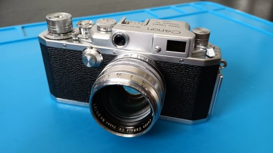

Hi. Got myself Canon IVSB2 in very good condition. Everything looks to work but there's yellow tint when looking through viewfinder. I don't mean rangefinder patch - entire viewfinder is slightly yellow. It's clearly visible when comparing to Zorki 1, Leotax F and Canon P.
I opened camera and gently cleaned all glass surfaces which were accessible. It helped to remove slight haze but yellow tint remains.
I did not remove main prism which would be required to clean surfaces which are hidden in mechanism.
Can anyone confirm if it's a "standard" feature of this camera or my copy has some problem?
