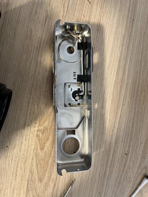

Recently purchased a QL19 (the new version), but seem to have some problems with the lightmeter. Specifically it acts as if a flash is attached as the meter reading changes with movement of the focus ring. I have cleaned the battery contacts, as well as the contacts under the flash as well as the two copper strips making contact with the bottom of the lens. This did not seem to fix the problem. I am however not that familiar with how the electronics in this camera work and could use some help.IMG_7508.jpegIMG_7510.jpegIMG_7509.jpeg
