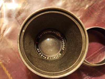

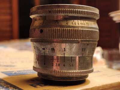

Greetings to everyone. I just joined this forum after I recently inherited a Leica IIIc with two lenses. The one is the 50 mm Elmar 3.5 and the second is the Zeiss Biotar. I have looked and looked online to find anything about this lens and to whom it could be sent to be cleaned internally as well as fix a piece of cementing between the lenses, (or at least I think that's what it is) that I can see on the edge when I look through it. The lens is in somewhat rough condition and of course, is very stiff from the dried lubricants. Does anyone know anything about this lens or who might service it?

That is a rare lens- a Carl Zeiss Jena 3.5cm F2 Biotar, listed as being in Arriflex mount- but completed in a Leica mount.
Henry Scherer in the US specializes in Zeiss repair:
DAG is well known-
The company that does thorough restoration,
located in Scotland.
Servicing this lens will not be cheap- but it is worth it, likely a prototype or custom manufactured.
Brian beat me to this one! Part of a batch of lenses completed in Feb 1937 according to Hartmut Thiele's book. Looks like a well-made mount, I agree with Brian about custom mount or prototype. I just looked at a couple of arriflex lenses on eBay, same 270 series, both are T coated. Given early production date of 1937, musta been a zeiss priority to coat such lenses at a time when the bulk of their lens production were not coated.
