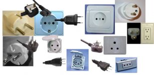

Best to inform you where you're going to stay in Europe because standardization is not yet plugged in.:D
Take a look at :http://en.wikipedia.org/wiki/Domestic_AC_power_plugs_and_sockets
Thanks, it's not my first trip to Europe, just the first one with any kind of digital camera, let alone two, a portable HD, and a second cellphone. Previously my Radio Shack plug adaptor set was fine for the one cellphone.
think your powercord is oke for 220V as long as you don't use a toaster with it.
Well the M8 charger is about the same size as a toaster :D Nevertheless my concern is that I don't accidentally make it into one.
