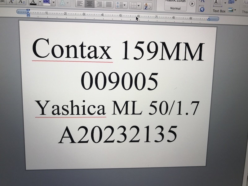

To document a test, I create a "title slide" on my computer in large font. Camera, serial number, maybe the lens. Then photograph the computer screen as the first shot on the test roll.
