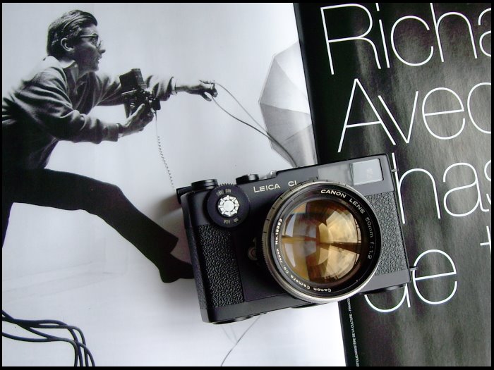

I totally agree with that. That's how I used a Canon 50mm f/1.4 LTM on a Minolta CLE for this portrait :

I'm considering pick up a Canon 50mm 1.2 screw mount and wanted to find out if it's too bit (IE interferes) with the rangefinder on a CLE.
