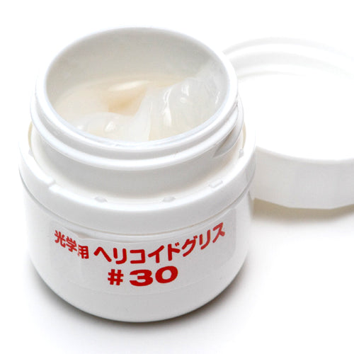

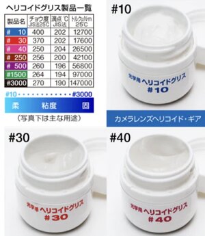

What grade of grease should I use? Should it be damping, or just a medium grade?
I‘ve been told that synthetic grease people use for telescopes is ideal. Medium grade seems to be right, I don‘t think that a Leica helicoid has worn to a degree that there is play.
They have different grade damper

Well, that wasn't too hard. I marked everything before disassembly so that it could be aligned again the same way, and strongly advise anyone else to do the same. The helical itself was much shorter than I expected, and VERY fiddly to re-engage once separated. I used the Medium grade Japanese grease that @Duofold RF linked to, because I already had it. It has a reputation for separating out, but the original lube had done exactly that anyway. I cleaned everything and used only a trace of fresh lube. My starting situation was that focussing near infinity had become sticky, almost a click, which quite took the pleasure out of using the rangefinder. Now the whole focus movement is super smooth again.
