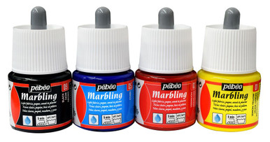

In the past I have effected temporary repairs with either of two approaches. For small pinholes I have, like others, used a tiny dot of liquid electrical tape being careful to use as little as possible and only covering the hole and its immediate surrounds. As long as it is used sparingly it worked well - I always delayed cocking and firing such repaired shutters for a few weeks though, in order to make sure that it is fully cured (working on the premis that if sticky this could result in gluing the shutter blind to itself when wound / overlapping). The other substance I used (once) with good results was Pebeo marbelling ink (surprisingly). In a 111a I had, the cloth of the shutter was intact but the rubberized solution which covered it was beginning to flake off in a couple of areas. The Pebeo product is thin - a bit thicker than ink, I suppose, but is much thinner than liquid electrical tape. I brushed it onto areas requiring attention a few times to allow it to build up a little. It did the trick by binding the flaking rubber of the shutter to the shutter cloth itself and as a solution it worked till I sold the camera some years later. This was definitely an experiment using a product not designed for this use but then again so is liquid electrical tape. For all I know the Pebeo fix may still be working. I agree that it is best to have the shutter replaced - but it is not always an option in the short term at least.

That is similar to the Pebeo paint I mentioned in my post above. Pebeo is a fabric paint but mainly used for "marbling" effects where it is floated on water then fabric (or paper) is laid onto the surface to produce a marbled effect. But it works for this purpose too - at least where the shutter is degraded rather than holed - which is how I have used it. So I can second your suggestion! 🙂
