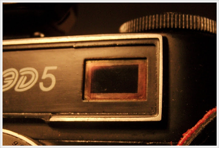

The VF on my FED5 is very dusty, Ronald, and the framing is close but not as good as my Zorki 3 or any where near the frame lines of the Bessa! One good thing about mine is that I can set the diopter adjustment on it so that I can see the whole frame with out mashing my eyeglasses against the VF. I also took a red,fine point marker and outlined the VF window on the front of the camera. That helps me know where the edges of the frame are.

"I also took a red,fine point marker and outlined the VF window on the front of the camera. That helps me know where the edges of the frame are."
That sounds like a good idea, now to find a sharpie!
Did you put a piece of frosted glass on the film plane and the shutter on bulb to line it up or just draw around the edge of the rf window? Maybe I'm over thinking this. Or could be that my eye wasn't centered when looking though.
