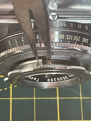

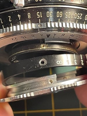

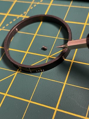

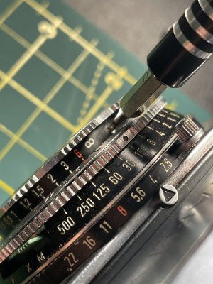

Just found out! Need a 1mm flat driver. To fit inside small set screw holes.
  1. Find infinity- should be easy since it has a prism. And mark it in the brass.
  2. Focus ring grip- back out the 3 set screws just enough to make flush from inside the ring.
  3. Put on scale ring and take out 1 set screw all the way out. Leave 2nd set screw in. Should be able to rotate freely
  4. Align the holes from both rings. With the empty set screw hole
  5. Be careful not to rotate the lens, since it’s at infinity
  6. Screw in focus/grip ring set screw from the empty hole of the scale ring.
  7. Rotate scale ring with driver and find the other 2 set screws.
  8. Then align scale ring to infinity and tighten.
