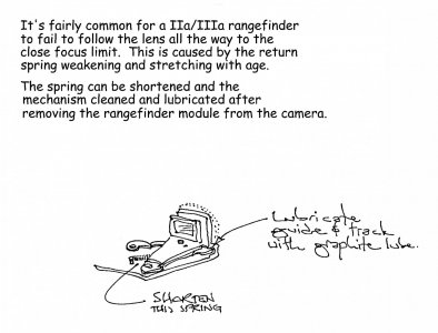

Acquired this body as a freebie rear cap for a super nice 50/1.5 Opton Sonnar.
I didn't expect much but was surprised that all the speeds through 250 seem to be good.
The bad news is the RF patch doesn't move, although it is very contrasty.
Also, Zeiss bumps.
Any tips on getting the rangefinder to work again? I figure it can't hurt to try to get it working. Also want to disable the infinity lock.
Also has anyone removed leather from a IIa or IIIa and had success removing the corrosion that causes Zeiss bumps?

My current project is a IIIa. I was able to carefully peel up the leather from the edge of the rear cover using 90% isopropanol dripped on the exposed glue as I slowly worked the glue free with an xacto knife. Scraped the green gunk, sanded the brass rivet, and sealed with auto touch up enamel. Glued back with pliobond on both surfaces. Was able to get the leather bumps totally flat. Sweet.
My rangefinder also wasn’t working and the slow speeds were sticking. It was simply old caked oil/grease in the works of both. Flushed free with naphtha and relubed with nyoil using watch droppers. The reason for my rangefinder sticking is because the tiny spring couldn’t pull hard enough vs the caked oil/grease.
The prism was separated/very dim, so waiting on a replacement now.

I think I will dive into the camera and try to loosen up the rangefinder. Maybe it also is just gunk and grime messing up the works.
I'm not sure I want to do anything with the shutter, I'm ok with only 1-1/250, assuming those are relatively accurate after a film test.
If I can't get the RF moving, no loss, I then will decide to send to Oleg. Postage is about $20, insurance about $2 for $200 coverage, considering the camera cost nothing, this is reasonable.
