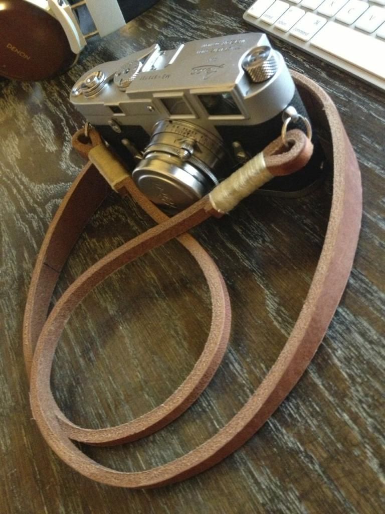

Last strap I made wasn't really anything special. it's just a hand-cut strip of leather with a few holes punched in it. Doesn't need to carry a lot of weight either.
Great looking straps gentlemen, Especially fond of the Mr Flibbles interpretation of the one knot strap. Is that one of those Gakken kit camera's?

A little trick with leather, if you want the edges to be smooth: lightly wet the edges with water on a sponge or cloth, then repeatedly rub something smooth over them (such as a ballpoint pen body, etc). The heat generated by the friction of the process will burnish the edges.
In my small production setting, I use a felt buff wheel on a dremel tool with a notch carved into it, to achieve an effect like this:

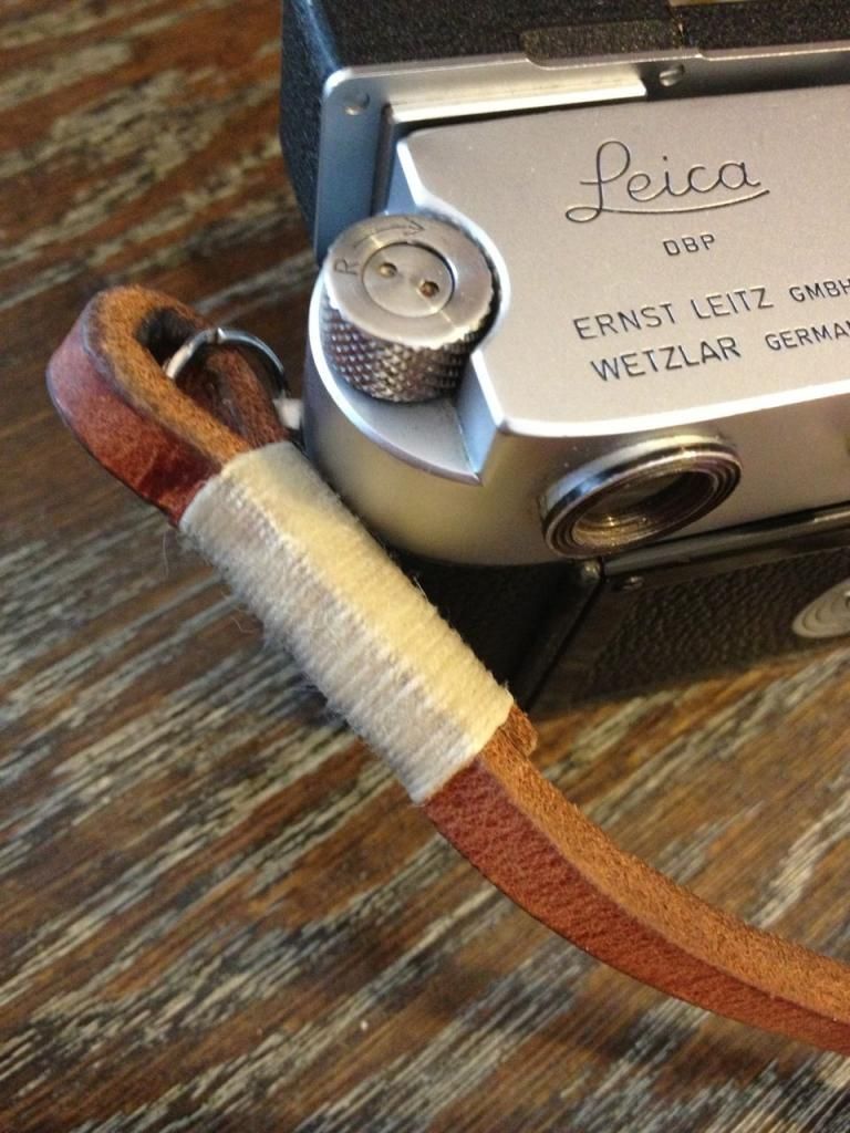

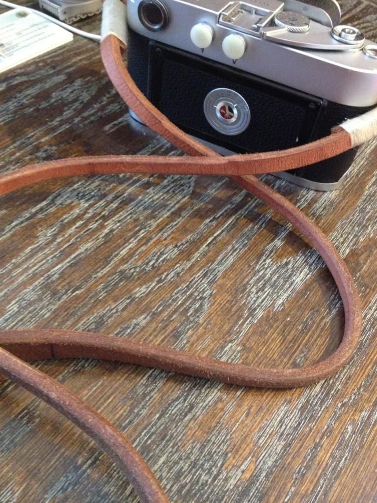

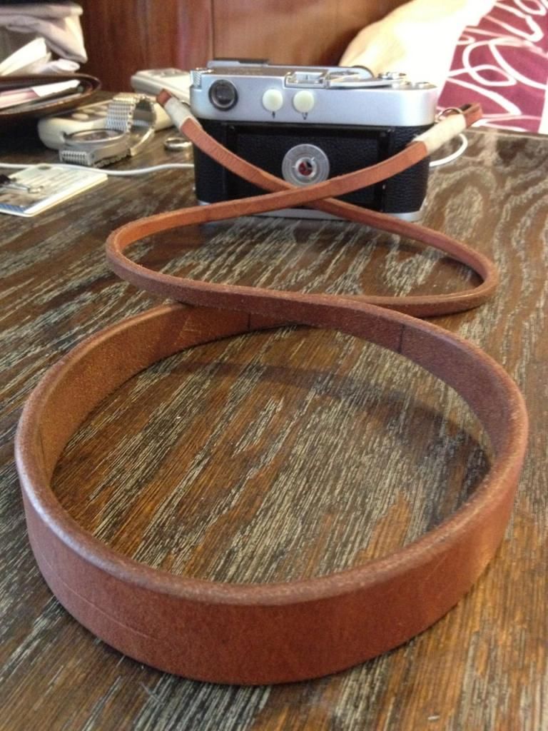

I made a strap of my own and I was originally going to do something similar to that with rope, but I ended up looking at too many pictures of Gordy's lovely straps and made a variation of his design (with integrated shoulder pad). I'm still convinced though that rope would have been a better choice ergonomically simply because, as nice as the leather looks, it's a little finicky at the lugs when hand holding the camera. I mean because of the inherent stiffness of such thick leather. I imagine rope would be far less so.
Here's what I've created:
Before burnishing the edges
After burnishing the edges (for comfort mainly) and some use
Ironically, I just placed an order for parts to make an ~$8 strap from nylon webbing because I believe this will be more comfortable and practical in the long run. Man I tell you... sometimes I just can't help but make something for the sake of making it (never mind practicality).

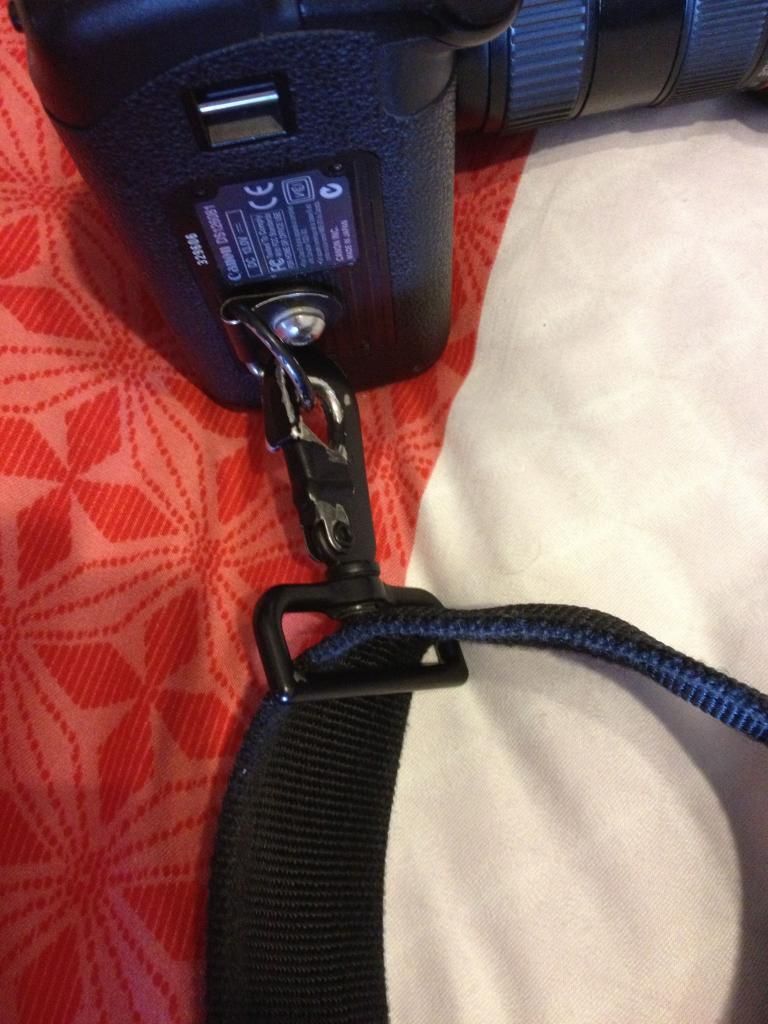

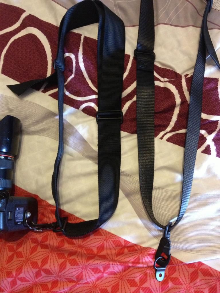

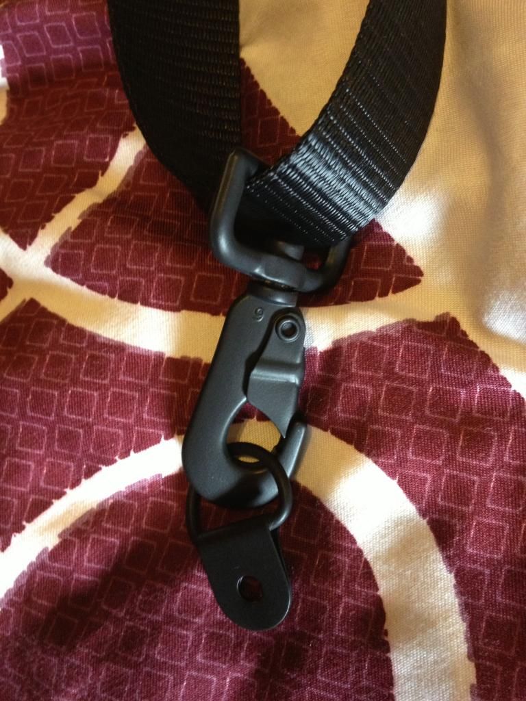

Here's a little secret I use for making all my "pro" sling style straps for about $20: www.strapworks.com
Here's a couple flavors (2" width for my canon beast, and a recently purchased 1.5" width for my hassy)

I think with a bit of usage that the leather will soften up more...it looks like it's well on the way there. You might be able to speed it up a little with Lexol or something of the sort (test it on a small, hidden area first, if you decide to go that route). Nice craftsmanship.
That's very nice! If cotton webbing were easier/cheaper to find I would use it because I prefer the way it behaves and feels in many applications over nylon, polyester, and polypropylene webbing.
My leather strap is actually pretty soft overall at the moment. It's simply bulky at the lugs and it's because I got greedy with the leather; in other words I should have just prioritized ergonomics over looks and used a lighter weight leather.
I guess I should add I think my leather strap would sing on a heavier camera like an SLR... maybe it's time for an old nikon or pentax...😀
