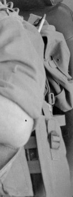

I've noticed a lot of defects on my last batch of negatives, some of which appear as black spots on the image, which means that it's not something (dust) added to the neg, but rather the image actually missing there. the worst case can be seen in the image crop attached (this one's really the worst)
What can cause this? I thought of a bubble, but it doesn't appear to be round enough. Then what??

I've noticed a lot of defects on my last batch of negatives, some of which appear as black spots on the image, which means that it's not something (dust) added to the neg, ...
... but it could be dust or some other schmutz on the film at the time of exposure. A dirty camera body, especially one with flaking paint inside the body, could cause such problems.
Dust on the negative would appear white on the scan. So a black spot on a print would be a loss of emulsion on the negative.
Hi Michael. How about this for a theory ? Prolonged wet time causing localised separation of particles of emulsion which then adhere to the film again causing simultaneously, white and black spotting ?
