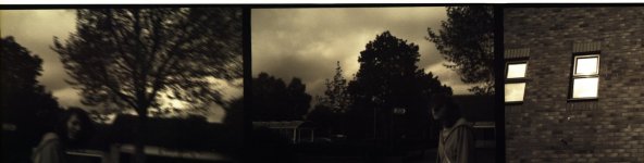

When I developed a C-41 roll in generic b&w chemistry I did it for about 10-15 mins I think. It was a month or so ago now. The same applies for E-6 film, you get the horrible dyes left on the film.
Try giving the film a wash BEFORE developing, with warm clean water to see whether anything washes off the neg (can't remember whether this helped, but it was a suggestion I was given before) and then do the normal b&w steps. DONT use bleach because it kills the negs in my experience.
The brown backing doesnt affect the neg tooo badly, try scanning or darkroom printing anyways, you might be surprised you can still get a photo out of it
underexposed (evening came too soon) and the other is the living room in the middle of the day, properly exposed with a touch up in photoshop - you can see what the brown layer does to a scan in the first strip

Thanks for the starting point tetris, my negs do have a similar appearance to the ones you posted. I had no idea what to expect to begin with, I've only been devloping for two weeks now and I had gone through all my backlog of b&w's so I thought I'd give the c41 a try. Is that process you mentioned similar to what they may have used in Three Kings, for the infectious pockets of bile scenes? As for Ash, it is interesting to see the results of scanning the negs, very intersting tone to it, am I to assume you just scanned it as c41? Also the second attachment, is that one scanned as c41 and converted or scanned as b&w?I'm still waiting on my scanner to arrive, canada post has screwed up another delivery on me, so I have to wait a little while longer to do some of my own.
