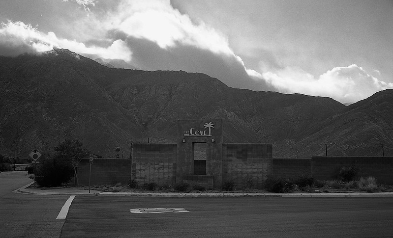

Sorry I didn't see this thread earlier , but I've just finished developing a roll of Ilford XP-2 in Ilford DDX 1:4 and these are what I got . I wouldn't hesitate to do some more .
Peter

The one above is my second roll, my first is below:
3XP2400Super-RodinalStan024 by Palenquero Photography, on Flickr
Leo Carrillo's Ranch by Palenquero Photography, on Flickr
3XP2400Super-RodinalStan054 by Palenquero Photography, on Flickr
For the first roll, I used the normal stop bath and Ilford Rapid fixer, and two agitation of 30 secs at first and 30th minute (semi stand)
For the second roll, I changed my agitation to 1 initial minute of agitation and nothing there after, at 60min, I dumped the developer, rinsed with water and pour TF4 rapid fixer.
