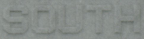

William, I have one roll of EFKE-25 that I've used from a 100' bulk roll. I developed it in Rodinal 1:25 for 4 minutes at 68 degrees F. The negatives are a bit dense for my taste and I think 3 1/2 minutes would have been better. It's extremely fine grain and sharp. The attached images are from that roll.
J&C Photo show Efke-25 in straight D-76 for 6-7 minutes at 68 degrees. If it were me, I'd try 6 minutes first. The same chart shows 4-5 minutes for Rodinal 1:25 and I think 4 minutes was a little too long.
Walker
