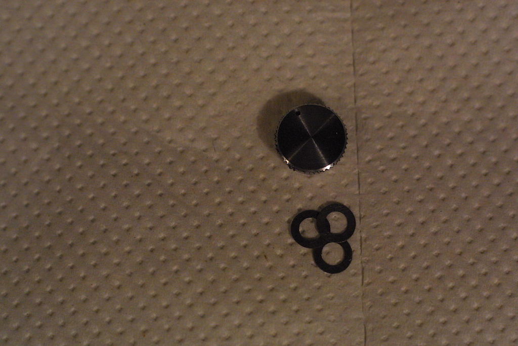

Sometimes they are "just" used as distances, though - my FED 3 had 3 washers stacked under the shutter speed knob - presumably to keep it clear of the top shell - or somebody might just have had 3 washers left at the end of a previous reassembly.. :)
Shutter speed knob with washers.
