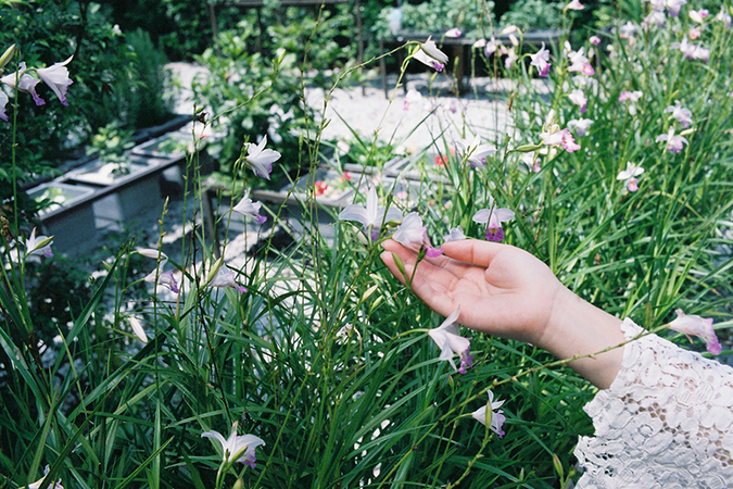

I recently tested out a Lomo f2/400 film (I never, never use this. It was just this one time and I got it back from the shops and a little confused at what's going on.
I noticed that there was a lot of grain in very bright daytime shots and I"m not sure what's going because I was using the Leica M6, there was a lightmeter etc.
I did ask the lab guy and his response was "you're out of touch with your cameras. Back then, this would be have the right exposure but these days, our photos are a little brighter. It happens to everyone so I understand."
But the problem was, I've always been using my Leica and was a little offended by what he said, as a month before using this film, I used Fuji Pro400H and my images were nothing fine? I'm not a total beginner (which he seems to think so, but I'm not an idiot either. :bang:)
So to tell me that I basically don't know how to use my camera is BS.
I'm thinking either the film didn't get handled very well when I bought it (maybe it went through x-rays) and quite worried now about the film I have in stock (iso 400) that if I were to bring it on my upcoming trip, I would get grain like this (as it has gone one round of the usual safe scanners at the airport but wasn't used).
The only thing different was that, for the Fuji Pro400 image I used a newer lens. But for the ones above it was the first lens I used and have got amazing images from it.
It looks like the 1st two were heavily underexposed and the lab corrected it, with this result.
