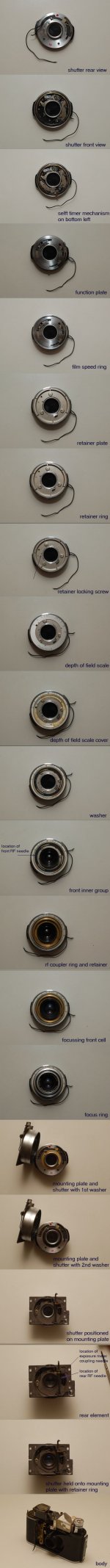

One of the steps I had to take getting the Vito CLR running properly again was giving the Pronto-LK shutter a dip and dunk in a grease removing solvent.
The pictures I took along the way when reassembling again may prove helpful for those who are thinking about doing something similar..
Unfortunately, the image upload is restricted to 900 pixels wide, so the aspect ratio is a bit unconventional... 😉
