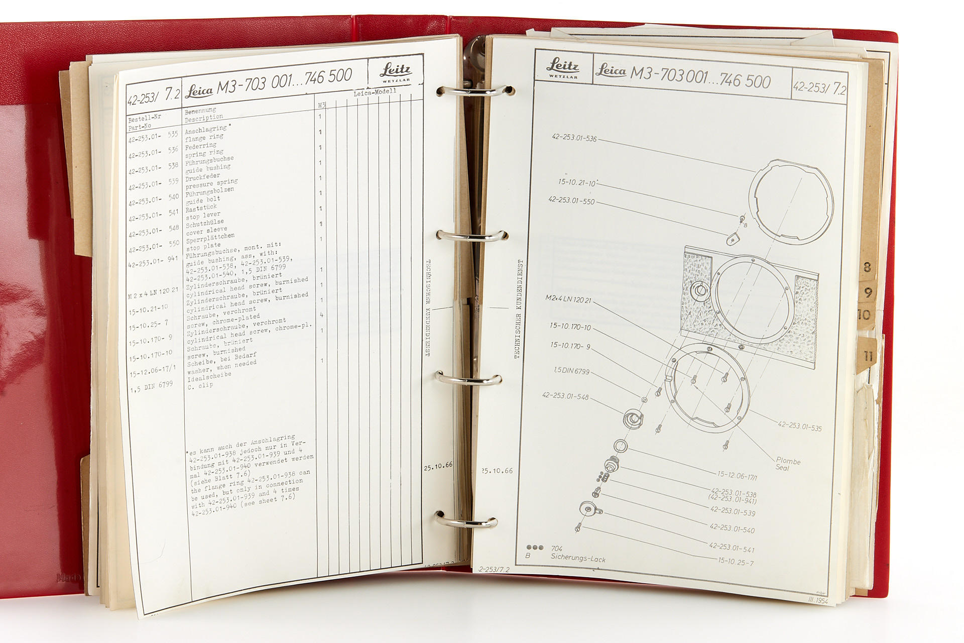

I have been in the hi-tech field (Engineering Configuration Management) most of my working life and would love to see some exploded view, detailed and dimensioned drawings with material call-outs (and any post-fab process) for vintage Leica cameras. That would be very interesting!
This example is the closest I have seen: a Spare Parts List/Exploded Views Manual 🔗. What is missing is the detailed/dimensioned/ engineering drawings w/material call-out.
A detailed list of Leica M3 spare parts issued for internal use by Leitz, including three hardbound photo books, one for each production variant of the M3: 700001-746500, 746501-782000 and from 782001, all beautifully illustrated and in excellent condition, also incl. a large folder with exploded views of all elements of the camera, and listing all the parts (also for various versions of the M3), around 100 pages, in excellent condition
Curious, what's in those three binders on the right?
