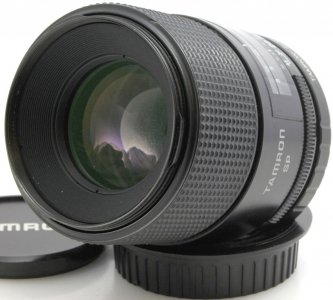

Not sure where to put this, but about an hour ago I was using my newly acquired Tamron 90mm f2.5 52bb to have a closer look at the insides of the the taking lens on a newly acquired Yashica D, (on which the shutter is rather inconsistent) which I thought had some fungus. Anyway when I held the 52BB at a certain angle, I could see thousands of tiny little dots that look like bubbles in water on one of the glass surfaces (possibly the front of the 2nd element of the lens, possibly further in).
I was wondering if anyone knows what these are and what their significance is?
Any help would be much appreciated.

Thanks for the info, raydm6. I don't think they were just bubbles in the glass, as there Sooooo many of them, and Tamron weren't known for bubbles in their glass.
Well, there must have been something there; if not bubbles, then could it have been separation between elements, or something on a surface that doesn't belong?
Yes, You're right, in the reply to my email asking about it, possible fungus or something else was mentioned, (maybe separation, I don't remember) so I was told to bring it in for a refund, so I did.
Hmmm, I get the impression that the "fungus or something else" may have been an erroneous opinion of the person who replied to me and told me to take it in for a refund, as I now see that the shop is reselling it as having no fungus or haze etc. I'll try and add one of the photos in the listing. In the pic you can see the "dots", and even though the shop now seems to think nothing of them, I'm not going to re-buy it, just in case they're wrong.

It does not look like „normal“ bubbles. It does not seem to be seperation and fungus. Maybe outgasing of lubricants or moisture that create this little bubbles. I guess it is not so easy to open and clean such a lens. I‘d stay away from it unless you get a really good deal.
I did have it, but took it back because in the reply to the email I sent, I was told to take it back for a refund. Now they've re-listed the lens with the same photos and don't mention the "bubbles", so I presume there's been a mistake in using these photos for a different example or other, (more senior?), members of staff don't consider them a problem.
The person that told you to get a refund gave you good advice. If there is a camera shop that has staff that does not consider this to be a problem: do not buy from them again. What else that is wrong with a camera or lens do they overlook.
This might be dried moisture, like what forms on the inside of a car windows. It will reduce contrast. It will cause flare. It needs to be opened up, and the Haze cleaned out. It does affect the image. I've cleaned many lenses with internal haze like this, usually moisture gets on the surface of the lens and dries.
