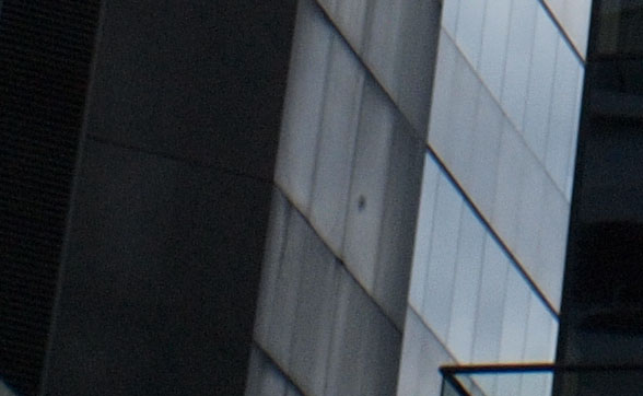

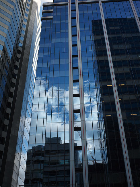

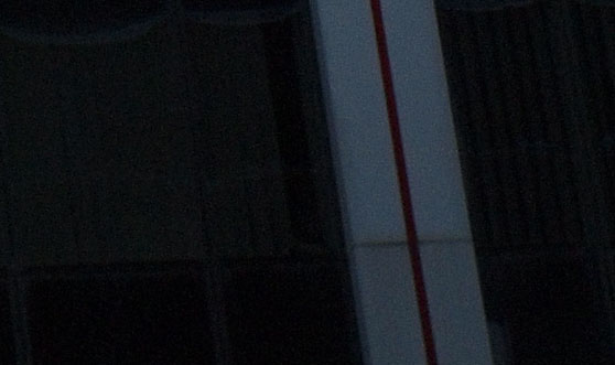

No 'mush' here Steve :)
Top left 100% crop
Top right
Bottom left
Bottom right
Centre
Cheers John
Taken as read, but the mush isn't a result of the lens or camera, it is a result of combining the two. The light path of a 35mm isn't what a 4/3 sensor is designed for, where the corners of the sensor are receiving the light at an acute angle. Olympus lense are telecentric and deliver light at right angles, more or less, with a much larger image circle than normal (pro rata in comparison to '35mm' FF), meaning you won't find any Olympus lenses that display soft corners relative to the centre. I guess if I'm used to pin sharp corners it can skew judgement.
